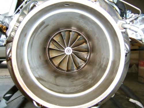

The chrome tail pipe for the turbine arrived yesterday. The instructions say there needs to be a .030 - .040 gap between the engine flange and the pipe flange. The first test fit shows a gap of .120 so I will need to do some grinding on the end of the pipe to adjust the fit.
The business end
The business end
