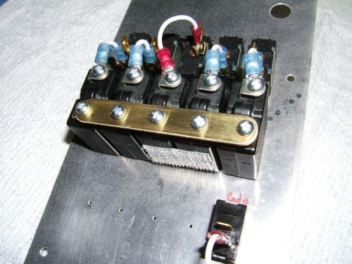

Fabricated a brass bus bar to connect the five top breakers. This bar will be fed by two 12 gauge wires from the battery.

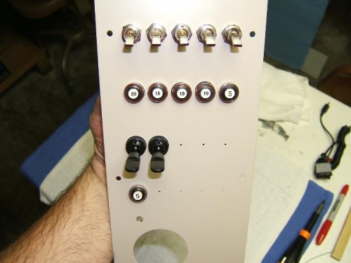

Also added another switch for a redundant governor circuit which will be fed by a small gel cell battery and tied to the main Gov circuit via a diode to charge the gel cell but still protect it from shorts in the main bus.
Brass strap cut to length
Bus bar installed
Bus bar installed
Second governor switch added
