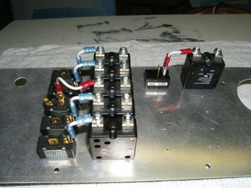

Brief Description:  Lower panel wiring
Installed switches and breakers in the lower panel and began making up the jumpers between them. Need to make up a short right angle screwdriver to access the screws on the switches.
Converted a cigarette lighter power adapter for my GPS so it can be internally mounted and hardwired to the radio/GPS switch/breaker.

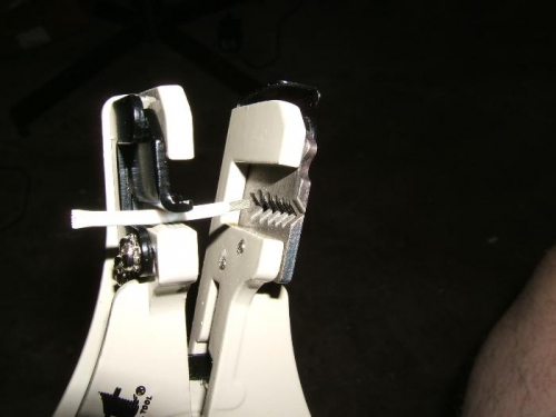

Wire stripper, works well on the tough teflon wire insulation

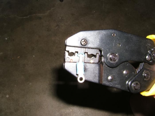

Crimping ends on the jumper wires
jumpers in place
jumpers in place
