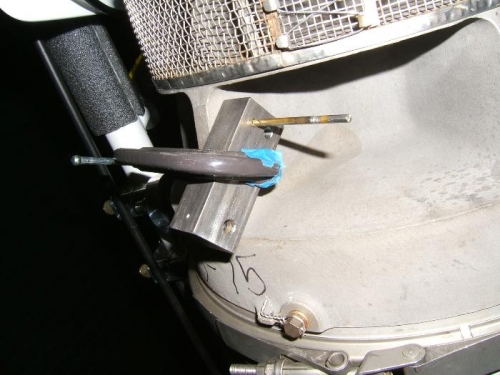

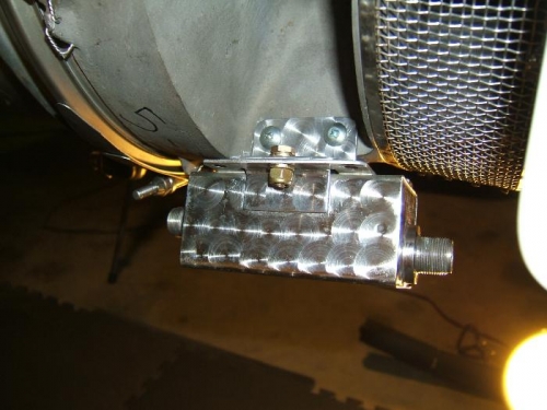

Used a drill jig block to hand drill two holes through the bottom engine web to mount the exciter coil box.

Using drill block to drill exciter mounting holes
Exciter box mounted
Exciter box mounted
