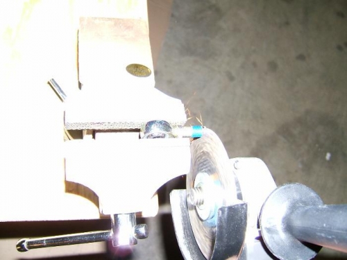

Brief Description:  Final alignment of engine
Shortened the left engine mount links another 3/16" each so I could get the mount short enough to level the engine on the roll axis by sighting the two mounting lugs with a cross tube from the rear of the frame. This brought the oil tank too close to the frame and also put the pulleys out of alignment slightly so I had to re adjust the front drag link to push the front of the engine to the left about 1/4".

Shortening the left mount ball links
