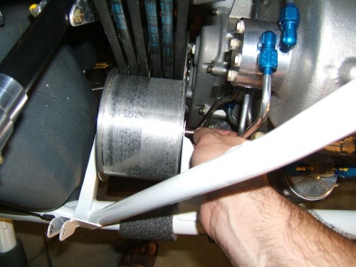

Adjusted the drag link that connects the front carrier bearing to the side frame to center the engine between the frame rails and align the engine pulley with the trans pulley, tightened the jam nut and loctited and torqued the bolt securing the drag link to the rubber mount on the frame.
Loctited and torqued the 3/8" bolt that secures the engine pulley to the front mount/clutch bearing. Final tightened the flange bolts for the front bearing.

Torquing the front bearing retaining bolt
