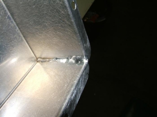

Used low temp aluminum welding rod to flow into the lower corners of the governor box to fill the last little bit of the joint where the TIG couldn't reach in an attempt to make the box as RF tight as possible.

Low temp weld
Low temp weld
No more holes at the corners
