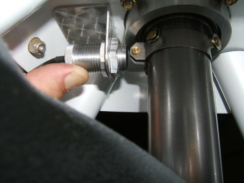

Rotor tach pickup
Installed the magnet ring on the main shaft and test fit the rotor tach pickup bracket. Decided to remove 3/8" from the back edge of the bracket so the pickup can be mounted closer to its middle for better adjustment range and harmonic balance.
Checking the fit
