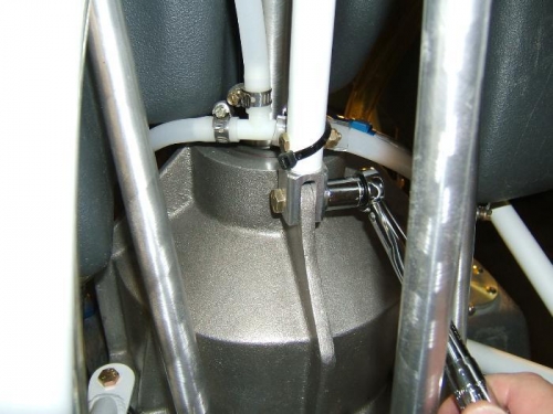

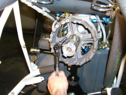

Transmission pulley, lift strut, seatpan
Installed the drive pulley onto the transmission, applying Loctite to the 8 AN3-6 bolts and torquing to 35 in/lbs.
Final installed the three transmission lift strut bolts.
Removed the adhesive Velcro strips from the seat pan that were installed during seat cushion fitting.
Torquing pulley bolts
Lower lift strut bolt
