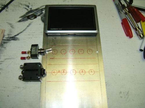

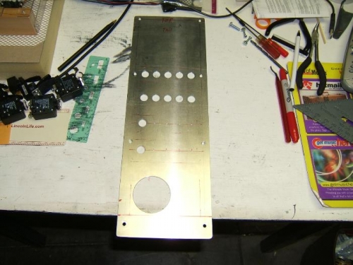

Located and drilled 12 holes in the lower instrument panel for 6 switches and 6 breakers. Drilled 8 1/16" pilot holes for ease of adding future switchs/breakers.
Located and cut the hole for the hour meter near the bottom of the lower panel.

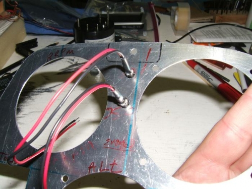

Drilled holes for the two clutch indicator LEDs, the engine and trans oil pressure LEDs, the starter engaged LED and the max fuel flow LED.
Switch and breaker rows marked
Lower panel holes w/ pilot holes for future use
Clutch engage/disengage LEDs
