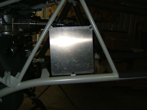

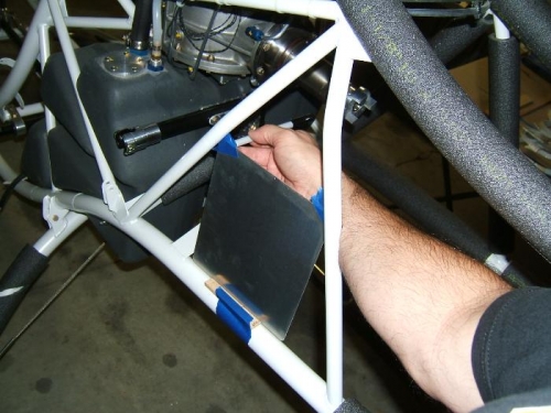

Began fitting the governor box to the frame. Cut angles on the top corners of the back plate so it would fit into frame correctly. Evenly positioned the plate on the three tabs, marked and drilled the 3/16" mounting holes.
Smoothed the sharp corners on the back plate and box.
