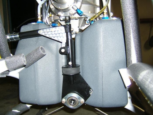

Brief Description:  Clutch
I realized looking at some pictures that I had the clutch arm that will connect to the electric actuator on upside down so I turned it over and also changed out the three bolts in the clutch that are pivot points to drilled bolts with castle nuts rather than nyloc.
The Clutch
The Clutch
