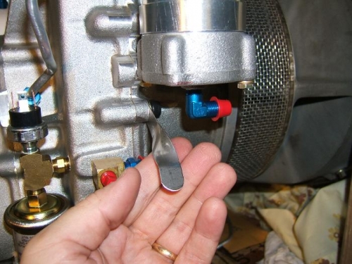

Decided to add a brace to the oil filter housing as a backup to the aluminum mounting strap. Fabricated the brace from thin stainless strap with a quarter twist and holes on both ends to brace the filter housing back to the gear case.

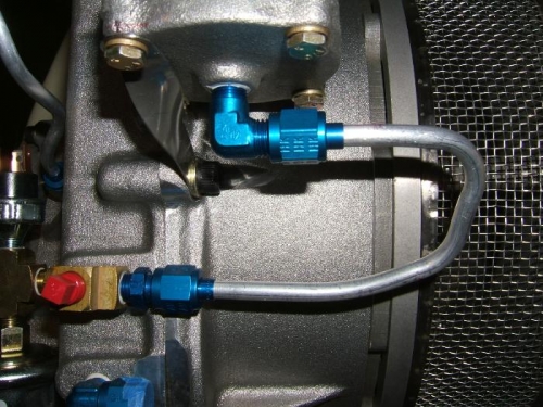

Finished making up the pump to filter feed line. Started putting a little grease on the flaring tool tip which makes the flares much easier forming and gives a nicer mating surface.

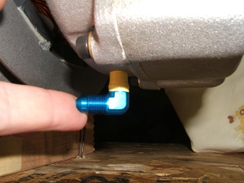

Removed the plastic plug from the lower scavenge fitting and drained a couple ounces of oil that remained in the case from the factory. Installed the 90 degree fitting using teflon tape instead of the sealing paste I have been using since the hole was oil soaked.

Additional oil filter brace
Filter feed line
Filter feed line
Lowest case scavenge fitting
