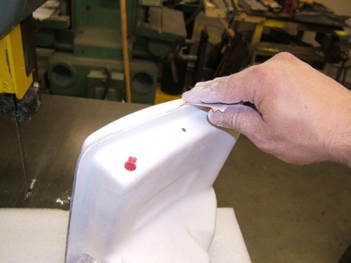

Sanded down the seam on the oil tank using the belt sander then finish sanded to a smooth radius by hand.

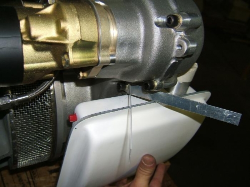

Began mocking up the mount straps for the oil tank using thin aluminum which I will duplicate in steel once proper fit is achieved. I will have two straps on top and two on the bottom.

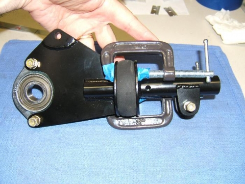

Began assembling the clutch now that the parts are painted. Used two C clamps to squeeze the rubber donut enough to get the cross bolt installed. Still need to polish the aluminum parts then the clutch can be completed.
Final sanding tank seam
Making template mounts from thin aluminum
Compressing clutch donut
