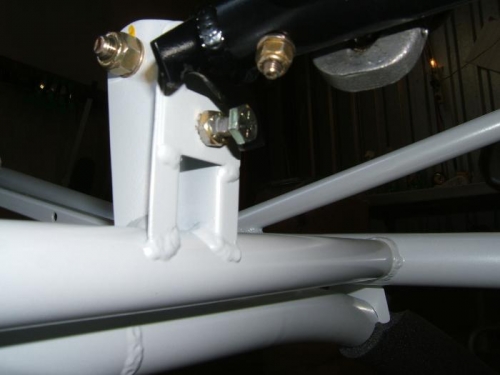

Re-worked the cyclic left/right stop bolt to get just over 6 degrees travel at the swash in both directions with the stick 1 degree to the right when the swash is level. Had to oval the bolt hole slightly to the right and grind about 1/16" more into the flat on the left side of the stop bolt.

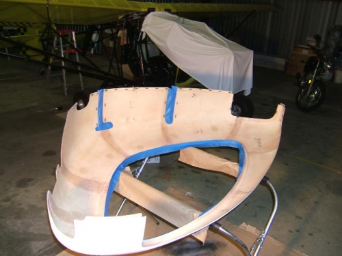

Sanded, taped and painted the inside of the right cabin half with gray primer then graystone texture paint over that.
Cyclic L/R stop bolt
Right cabin half ready for interior paint
