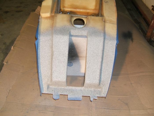

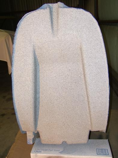

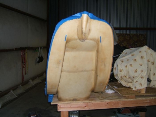

Sanded and texture painted the back and bottom of the seat pan in areas that will be visible with the cabin installed.

Taped, ready for paint
Back of seat pan textured
Front bottom of seat pan textured
