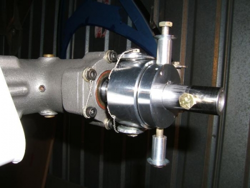

Safety wired the six cap head screws that secure the cover on the output side of the T/R trans.

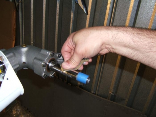

Sanded/polished the fine machining grooves on the T/R shaft to reduce the chance of grit sticking to the grease and jamming the slider.
Reinstalled the slider and safety wired the bolts.
Smoothing the machining marks on the shaft
Slider installed and wired

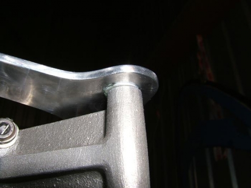

Delrin wear washer on slider scissor
