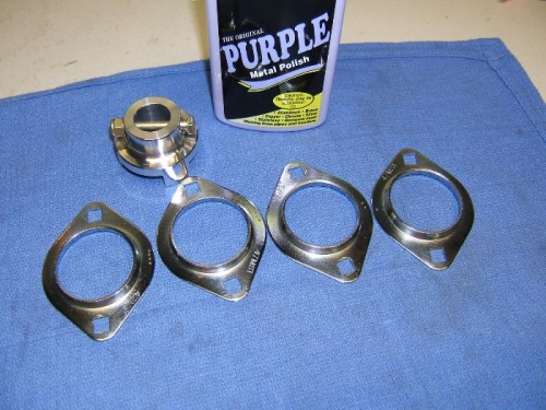

Polished the four carrier bearing mounts and the output coupler on the main trans. Began polishing the battery boxes I got from Hap Miller.

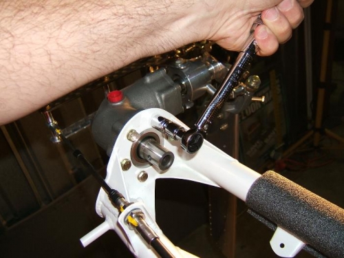

Changed the six bolts that hold the tail rotor gearbox to the frame from the AN4-7A that came in the kit to AN4-6A so that they wouldn't need 3 thick washers under the heads to prevent the shank bottoming in the hole. Torqued the new bolts then safety wired.

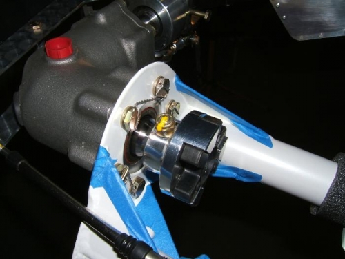

Installed the drive shaft coupler, torqued the nut and marked with torque seal.
Polished carrier bearing clamps and coupler
Torquing tailrotor trans bolts
Installed drive shaft coupler
