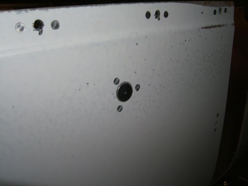

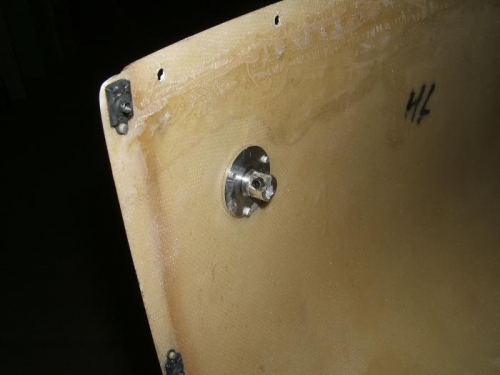

Located and drilled the holes for the static port and the pitot tube in the bottom of the cabin halves. Riveted the static port and pitot mount.

Installing static pressure port
Installing pitot tube mount
