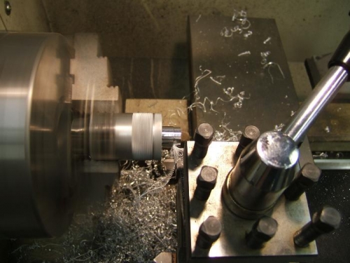

Fabricated an aluminum mount for the pitot tube that will get riveted into the bottom of the cabin behind the chin window. The kit supplies a 1/4" copper pitot tube that gets soldered into a steel plate that is held into the cabin with three screws. I decided it would look nicer to flush rivet this mount into the cabin before it gets painted then clamp in a polished aluminum or stainless tube later.
Turning pitot tube mount

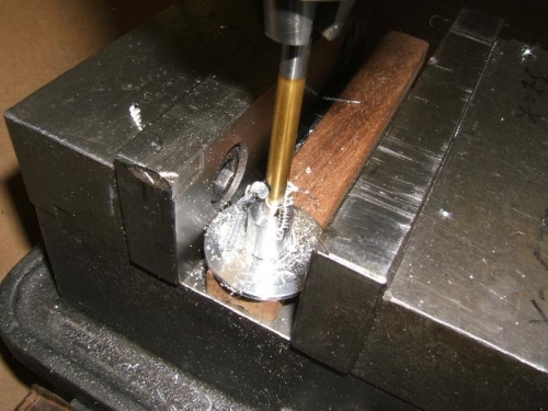

drilling 1/4
drilling 1/4" hole for the tube

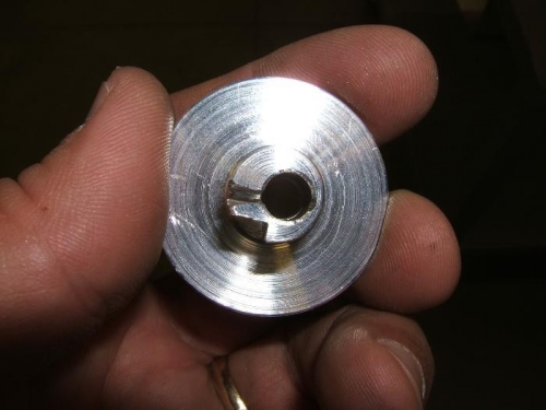

Slotted and tapped to clamp the pitot tube
