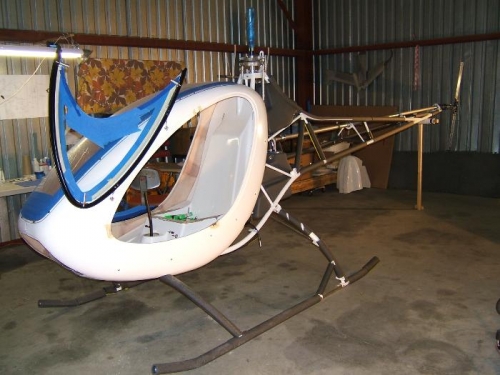

Filled the air pocket in the left door sill.

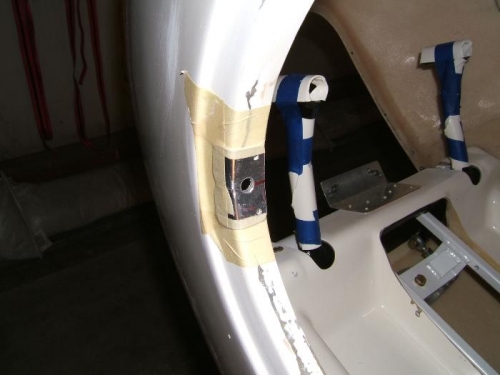

Drilled rivet holes in the three strike plates, taped them in place and used the door to mark the latch hole positions. Installed the latches in the door frame. Drilled the latch holes and opened them up gradually until the door latches snugly against the cabin. Attached the hinges and verified that the door will open and latch correctly.
Sanded the rear edge of the right door Plexiglas to a smooth radius.
Filling air bubble in door sill
Drilling strike plates
Door hinged and latches installed
