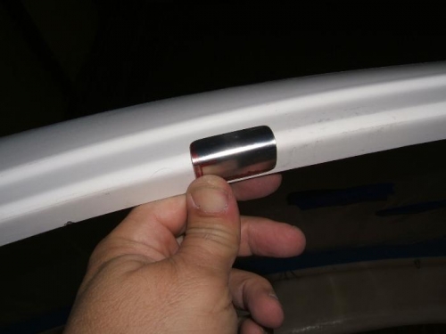

Sanded and rounded the rear edge of the left door plexi. Cut out three .025 aluminum strike plates for the left door latches and bent them to match the shape of the door sill. Drilled 3/32" holes in the plates for rivets.

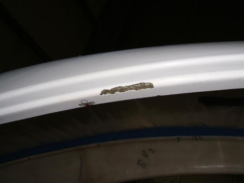

In working on the strike plates I found yet another area in the left sill that has air bubbles under the gel coat and will need ground out and filled. The glass work on the left body half is full of air pockets in many of the tight corners. The right side was made with lighter weight cloth and is much nicer.
Lower strike plate
Lower strike plate
Upper strike plate
Upper strike plate
More crappy glass work
