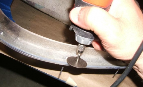

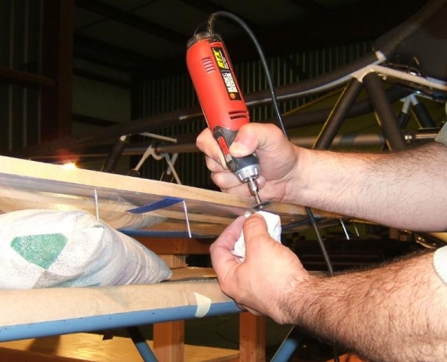

Used the dremel to grind down the back side of the door rivets flush with the fiberglass so the doors can close flush against the cabin. Used a wet rag on the rivets during grinding to keep them from getting too hot.

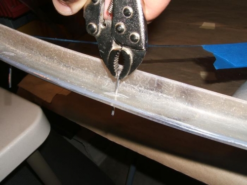

In an effort not to put too much stress on the plexiglass I stopped short of popping most of the rivets. So, after grinding the rivets smooth I was able to pull the pins out the back of the rivets that did not "pop".
Grinding the rivets flush
Wet rag heatsink
Wet rag heatsink
Removing rivet pins
Removing rivet pins
