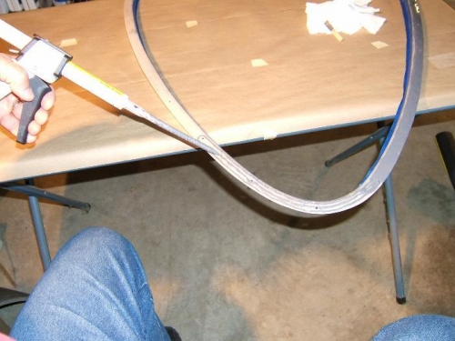

Bonded the plexiglass half doors to the fiberglass frames with Hysol 9460 epoxy and 1/8x1/8" countersunk aluminum rivets then clamped the doors in the cabin openings while they cure.

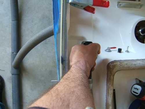

Used the sanding drum in the drill to open up a relief in the left door frame and cabin lip above the collective pocket to provide clearance for my knuckles.
Applying epoxy to the door frame

Relief in door frame for collective
