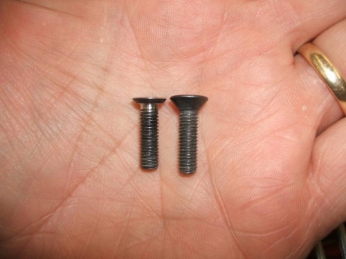

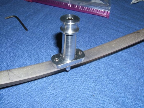

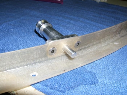

Worked on fitting the three door latches to the left door frame. In order to let the counter sunk screws fit flush with the bottom side of the thin fiberglass door frame I turned the screws in the lathe to thin the head then shortened them almost flush with the top of the latch
This took care of the rear latches but I still need to work on mounting the front latch since it is located in the tight radius at the front of the door frame and the frame is thin in that location. I will need to either build the frame thikness there or move the latch a few inches along the frame to a flatter, thicker section to allow the screws to be counter sunk.
Reworked screw on the left
Top
Top
Bottom
Bottom
