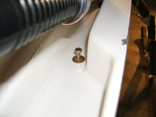

Seat pan & switches
Cleaned out and filled voids in the seat pan glass, filled chipped out areas around the screw holes.
CA'd and reinforced a crack in the glass at the front corner of the collective pocket.
Located and drilled holes for the starter and start fuel switches and for the clutch switch and fast engage button.
Installed a stop bolt in the bottom of the collective pocket.
Hole blowout filled and re-drilled
Starter & clutch buttons, Fuel valve
Collective down stop
