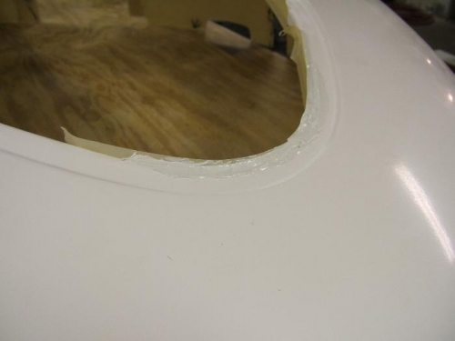

Fixing voids in cabin fiberglass
Finished grinding out the air pockets in the left side cabin half under the gel coat. Filled the voids with Adtech resin filler.
Filed/sanded the filler to match the surrounding glass.
Sanding revealed at least one more area that needs air bubbles ground out and filled.
Did some initial test fitting of the left half door on the frame and cabin opening.
Large void front edge of door opening
Filler in place
