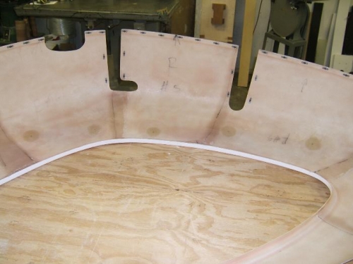

Brief Description:  Reinforced cabin mounting holes

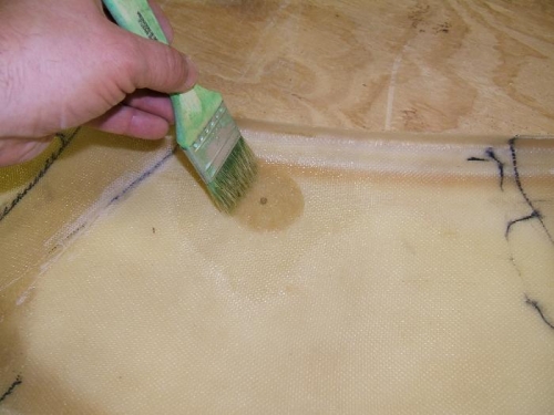

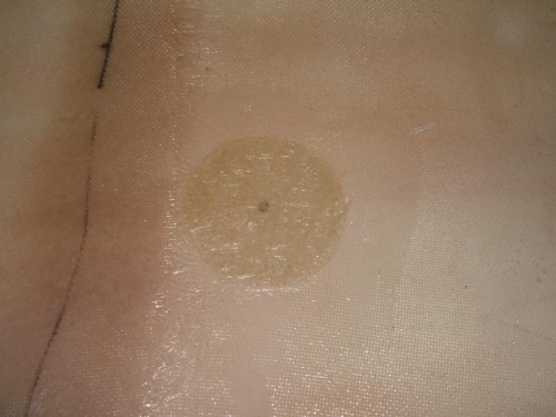

Applied six 2" glass matt patches to the inside of the right cabin half over the mounting holes. These will add some strength to the screw holes as well as help shim the cabin to floor pan to reduce dimpling under the screws.
I plan to do the same on left cabin half tomorrow.
