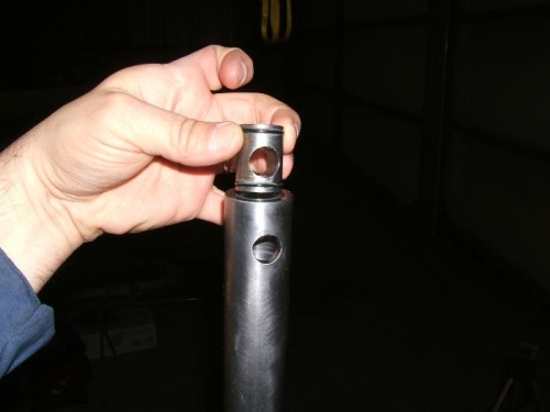

Swabbed out and vacuumed the interior of the main shaft to clean it. Applied a coat of grease to the inside of of the main shaft then inserted the o-ringed plug into the top.

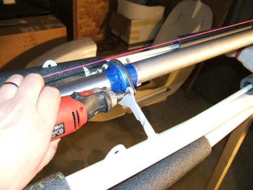

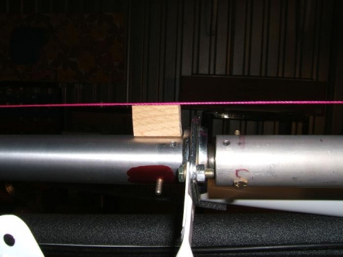

Installed all three tail driveshaft segments and checked overall straightness. Both carrier bearing mounts needed to have the holes ovaled to the right slightly to allow proper L/R alignment. The drive shaft tubes are now ready for paint then final installation and alignment can occur, then two small locating holes will be drilled through each carrier bearing mount and plates to hold that position.
Main shaft plug / head pin shear lock
Adjusting carrier bearing holes
Verifying drive shaft is straight end to end
