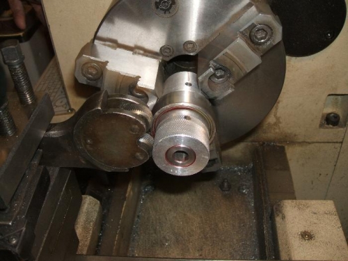

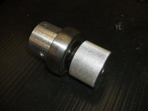

Bruce helped knurl the two center carrier bearing bushings to bring their diameter up by about .008" so they are a snug fit in the replacment center tube I got from Eagle R&D which was slightly larger than the original. After getting a nice fit on the tube I double checked the length and drilled the 4 holes that attach the tube to the bearings. This completes the tail drive shaft except for setting the overall alignment and painting the tubes.

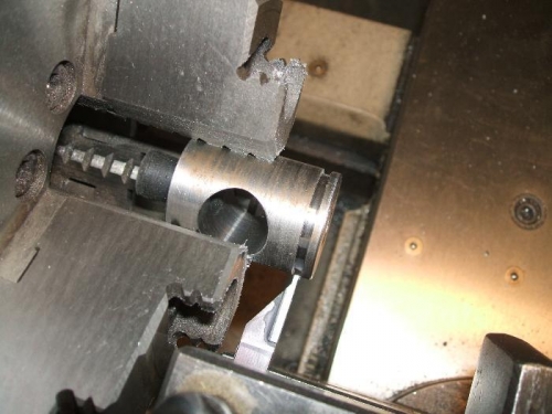

Turned 2 O-ring grooves in the main shaft cross pin retaining plug. This will seal the top of the main rotor shaft from the elements rather than epoxying in a wood plug as the plans call for. Also inserted a rubber stopper in the bottom hole in the plug to seal it off, this will get CA'd to make sure it doesn't work its way out and cut off flush.
Knurling carrier bearing
Done knurling
Done knurling
Cutting o-ring groove
