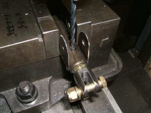

Located and drilled 3/16" hole for bolt that secures the threaded plug into the top section of the clutch slider. Hole is 3/16 from the edge of the plug and clears the end of the threaded in clevis by about 1/16".

3/16 hole to secure threaded plug
