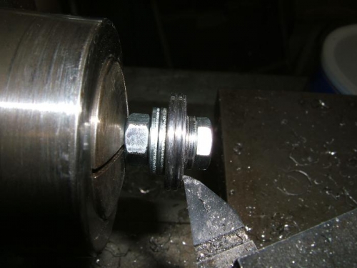

Turned down the radius of the fender washers and coined washers that secure the tail slider and ball links to allow additional clearance for maximum slider travel.
Re-installed the washers.

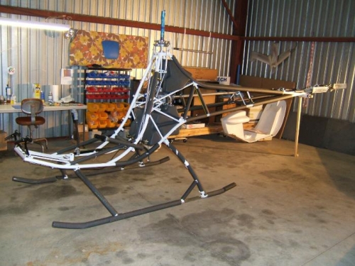

Safety wired the six cap head screws on the tail rotor hub barrel.
Drilled safety wire holes in the tail rotor pitch arms.
Turning down fender washers
Tail hub safetied, hole in pitch arm
