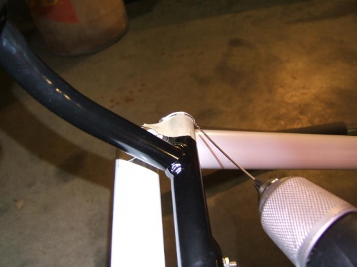

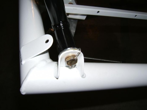

Drilled safety wire holes at each end of the pedal mount tube and wired the the bolts and end plugs.

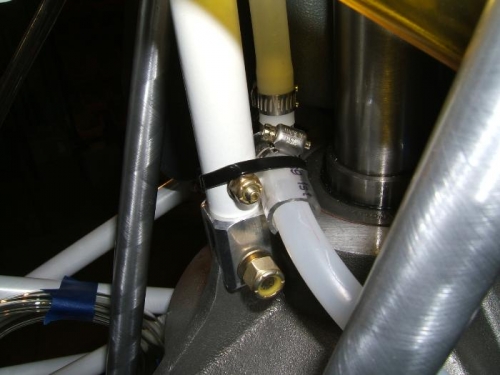

Installed the transmission lift strut but have not tightened the nuts yet. Tied the fuel vent tube to the lift strut to assure it stays away from the main shaft.

Drilling safety wire hole
Bolt and plug safetied
Vent secured to lift strut
