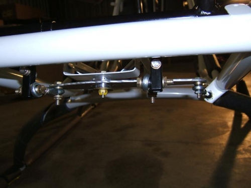

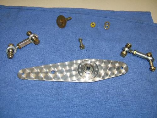

Sanded, polished and jeweled the torque pedal lever.
Installed the pedal lever in the frame and connected the linkages to the pedals and tail pitch cable and made preliminary adjustments to the travel stops. Will need to final adjust these once the tail rotor is installed to achieve -8 to +18 degrees on the tail blades.
Torque pedal lever
Torque pedal lever

Pedal linkage front view
