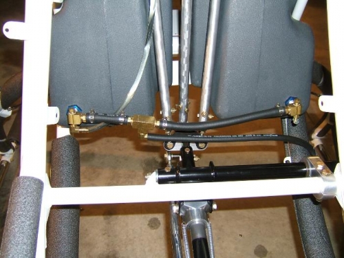

Installed Tee and fuel feed lines between the bottom tanks then connected the Tee to a temporary line and valve to close the system and provide a way to drain the tanks after the leak test.
Filled tanks with 18 gallons of gasoline, no leaks detected, left the fuel in the tanks for now.
Fuel feed lines and Tee

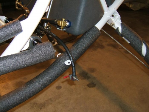

Drain valve
Drain valve

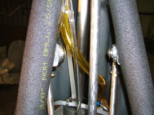

Sight tube
Sight tube
