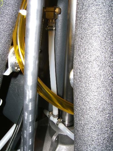

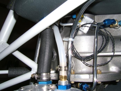

Brief Description:  Fuel vent lines
Installed vent lines from lower tanks to top tank. Used my propane heater to heat the stiff tubing and form bends so the tubes could be routed as needed.

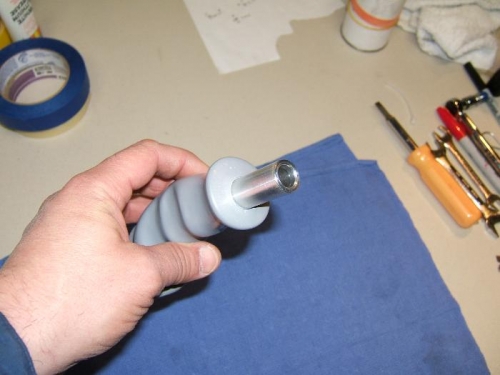

Cleaned up mold seams on the cyclic grip and sanded smooth then glued the aluminum coupler into the bottom of the grip. When the seat pan is next installed I will need to determine the optimal height and twist for the grip.
Fuel vent lines
Fuel vent lines
Left, lower vent line
Cyclic grip w/coupler glued in
