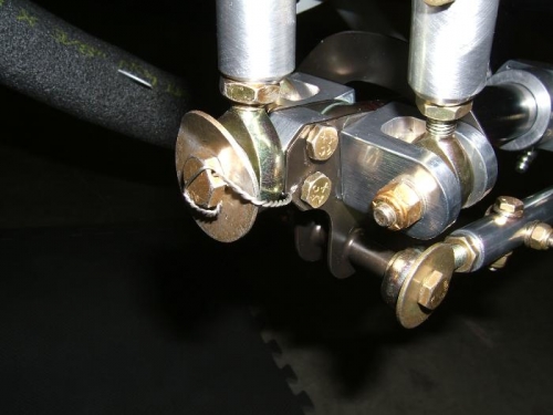

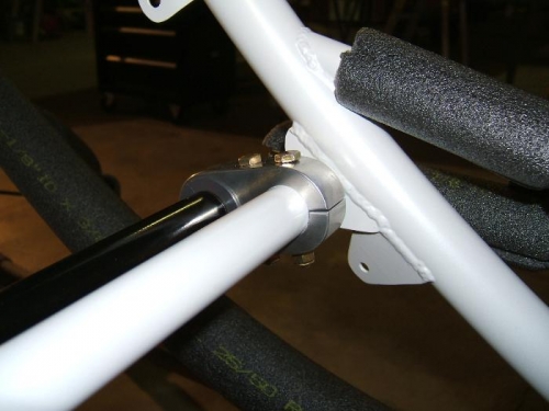

Removed the collective tube to apply grease to the bearing surfaces then installed with locking nuts and cotter pin. Re-installed the cyclic tube greasing the collective attachment bolts, installed lock nuts at the attachment points and mixer/control tubes.
Safety wired the collective slider bolts and lower pitch tube bolt.
Added about 5 squirts of Green Grease to the hood bearing via the grease zerk. Did not see grease out of the seal but not sure how much should be put in so I stopped at 5 pumps until I check into it.

Collective tube mount
Pitch link bolt safetied to mixer
