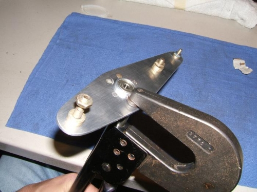

Installed the remaining four rivets in the pedal scissor arm bearing flange.

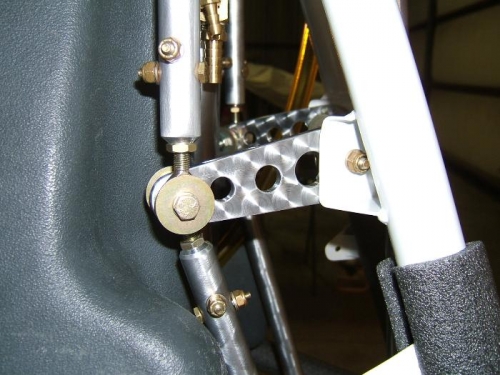

Final installed the walking beams to the frame.

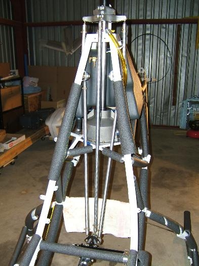

Installed the swash and attached the cotrol tubes ready to adjust travel and rigging.
Directional pedal arm
Walking beams installed
Control tubes from mixer to swash
