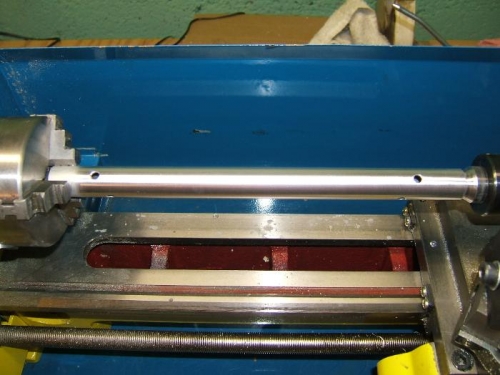

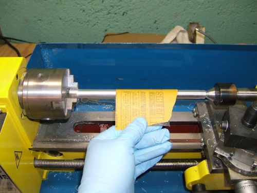

Started sanding and polishing the aluminum control tubes. Chucked the tubes in the lathe and spun them while wet sanding with 400 then 1000 grit then applied purple polish and buffed while spinning the tubes. Still have three tubes remaining to polish.
1000 grit
1000 grit
Ready for polish
Ready for polish

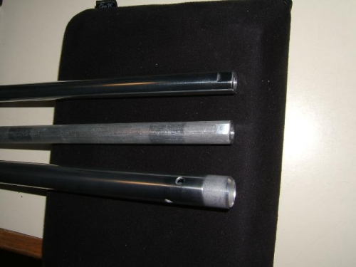

Before and after
Before and after
