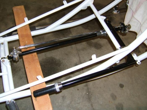

Began re-assembling the cyclic and collective controls.
Greased and final adjusted the cross bolt in the mixer after adding a thin washer under the castle nut so it would better engage the cotter pin. The washer diameter had to be slightly reduced to fit into the recess in the clevis, which was achieved by tightening it on a smaller bolt and spinning it against a file.
Installed lock nuts and cotter pins in all locations that should not need to come out again during rigging.
Installed controls into the frame in prep for rigging swash travel.

Controls in frame
Controls in frame
