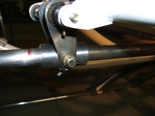

Cleaned up my work table then started prepping the flight controls for paint. Disassembled the collective and cyclic tubes, cleaned out the inside of the tubes then pushed an oil soaked paper towel through the tubes to apply an oil film to hopefully help with internal rusting.
Placed the cyclic and collective tubes in the frame and marked the travel limits for the collective slider so that section can be taped off and remain unpainted.
Slider travel marked
