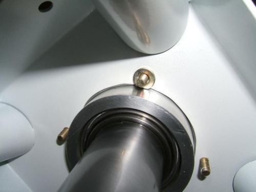

Installed hood bearing on main shaft and final installed the four bolts that secure it.

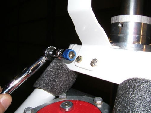

Installed the anti-rotation bracket and its four mounting bolts torqued to 50 in/lbs.

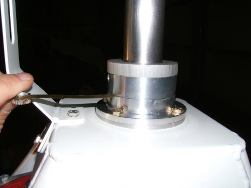

Checked hood bearing to shaft alignment with the supplied collar. There is supposed to be less than .005 gap and it looks to be about .002-.003 as my .006 feeler won't come close to fitting in the gap. I will check this more accurately later with a dial indicator.

Tight fit for the hood bearing nuts
Protecting the finish
Mind the gap
Mind the gap
