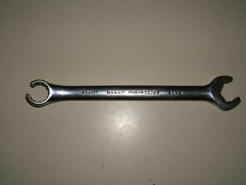

Brief Description:  Line wrench
After removing the top oil line on the transmission to re-shape it to clear the fuel tank I was having trouble tightening one of the fitting nuts with my open end wrench due to tight quarters. So, I stopped by the pawn shop and picked up a 9/16 box end wrench for .50 and few minutes with my angle grinder had my very own line wrench which will hopefully give me the angle I need to re-tighten the fitting and will likely come in handy on the remaining fittings on the engine.
50 cent pawn store wrench
