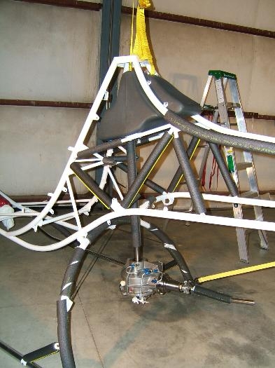

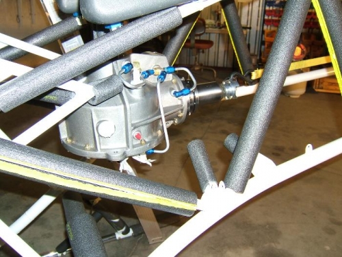

Installed main transmission into frame using the strap hoist.
Pipe insulation foam was used to protect the frame and trans finish during the lift.

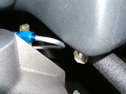

The top bearing oil line needs re-bent to clear the bottom of the fuel tank so I removed it to allow the trans to be mounted and will need to re-shape and reinstall it.
Beginning the lift
Beginning the lift
getting closer
getting closer
Oil line won't clear tank
