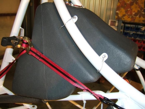

Brief Description:  Upper tank

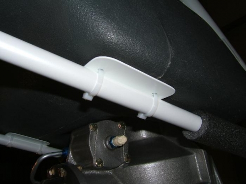

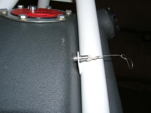

Installed upper fuel tank. Used ratchet strap to pull it tight into position so the mounting holes aligned with the tabs on the frame. Had to bend a couple of the tabs in slightly toward the tank. Installed the two small plates under the tank that spread the load where the tank sits on the frame tubes.
Ratchet strap pulling tank tight
Fishing the bolts through, tab gap
Load spreader plate
Load spreader plate
