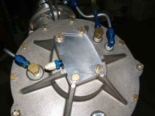

Removed masking and plugs from transmission and final installed oil fittings and lines using Permatex thread sealer on tapered thread fittings.
The 90 degree fitting for the input bearing required filing the edge of the input flange slightly to allow full installation of the fitting.
Installed oil filter and safety wired the filter cover bolts.

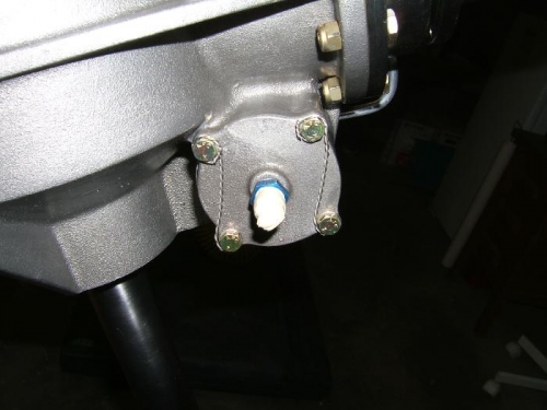

Safety wired the oil pump cover.
Fittings and line installed
Trans oil filter cover
Trans oil pump cover
