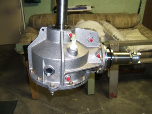

Brief Description:  Main transmission prep
Removed drive pulley.

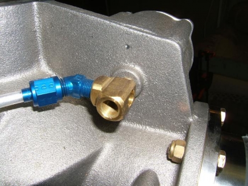

Removed fittings and tubing from the main transmission in preperation for cleaning, masking and clear coating. Installed plastic plugs in the fitting holes.
Removed filter and cleaned inside of filter housing. Determined best orientation of the filter cover where it best matches up with the filter housing and placed a punch mark at top center for future reference.
Masked off the one fitting that was final installed at the factory.
Lines removed
Lines removed
Plugs installed
Plugs installed
