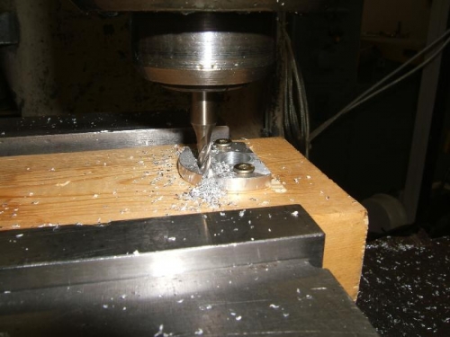

Brief Description:  Door latches and frames
Milled down the sides of the three door latches so they will fit on the narrow door frame, radiused the corners and chamfered the edges. Ground a large radius on the bottom of one latch so it will better fit the radius at the front of the door frame.

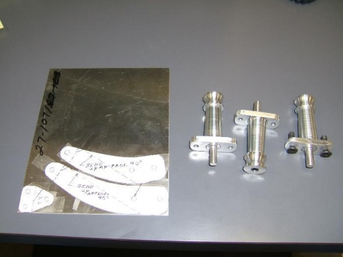

Assembled the three latches with the latch pin, spring and knob. Knob screw will need loctite and latch pin greased when final assembled.
Cut out left side door hinges using paper templates on .062 aluminum.

Milling down latch sides
Latches finished, hinge templates
