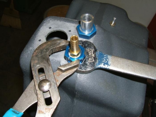

Brief Description:  Lower tanks
Assembled fittings with Permatex thread sealant, installed o-ringed fitting and bolts into tank, rinsed out tanks, installed o-ring sealed access plates and screws then plugged fittings and filled with water to leak test. No initial leaks noted, left full of water over night.
After 12 hrs full of water no, leaks were seen. Drained tanks and set aside to dry.
Lower left tank drain thread sealed and installed
Using split nut to tighten fitting. Thanks Juan.
Access plate going on with o-ring sealed screws
