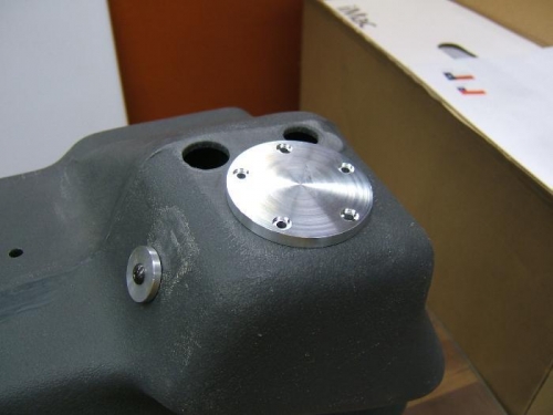

Brief Description:  Fuel tank prep

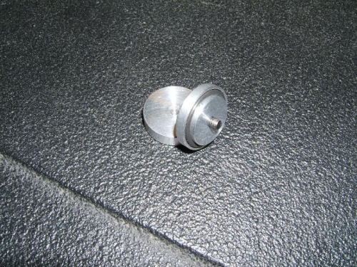

Machined recesses under screw heads for o-rings to seal access plate screws. Turned o-ring sealed plug for the left lower tank to seal the sight gauge fitting hole that will not be used.

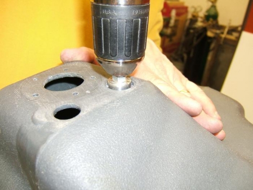

Used hole sanding tool to level and smooth the inside surface of fuel tank fitting holes so the o-rings have a better chance of sealing.
